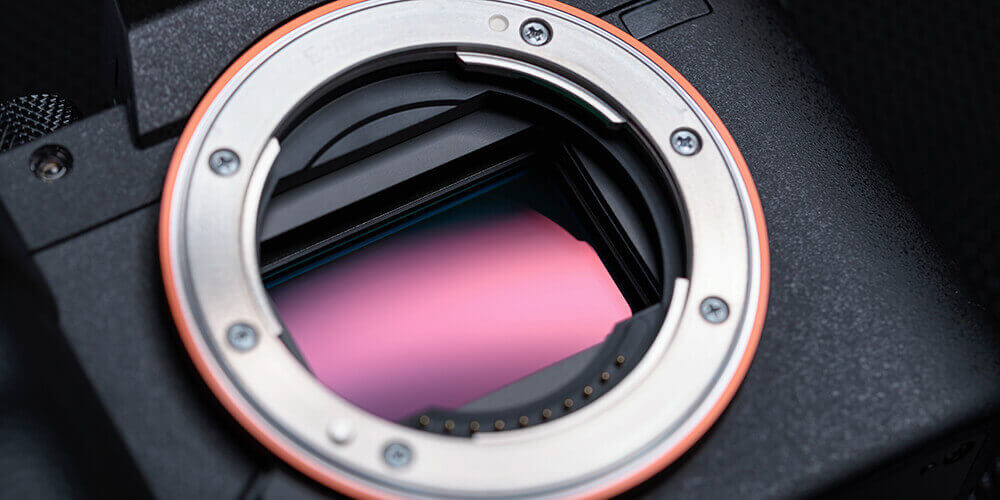

Sony Semiconductor has announced new CMOS image senors. There is a new rolling shutter 44 full-frame sensor, as well as a new 61mp full-frame sensor.
