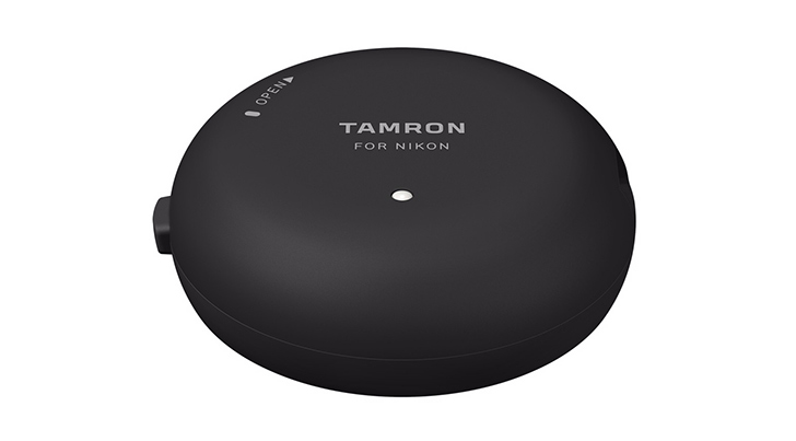

Tamron TAP-in Console™TM (Model TAP-01)
February 22, 2016, Commack, New York – announces the launch of the Tamron TAP-in Console™ (Model TAP-01), a new lens accessory that enables firmware updating and customized setups for selected Tamron lenses. The TAP-in Console™ is expected to be available in March. The price will be announced shortly.
PRODUCT HIGHLIGHTS
For the first time, customers can update firmware in selected Tamron lenses and customize various lens functions to meet their needs simply by attaching a Tamron TAP-in Console™ and running the Tamron TAP-in Utility software on their PC or Mac. Previously, firmware updates could be performed only at a Tamron Customer Service Center. Using the new accessory and an internet connection, customers can access a dedicated website and update firmware themselves anytime, anywhere. In addition, selected lenses can be customized by changing various settings (described below) to match the customer’s preferences based on how they like to use the lens, making it even more versatile and user-friendly.

2. Tamron TAP-in Utility Software
Customers download the free Tamron TAP-in Utility and install it on their Mac or PC. Updating firmware and customizing various lens functions is as easy as connecting the TAP-in Console™ with a USB cable and making selections. An internet connection is required for firmware updates.
3. Updating Firmware
Customers can update firmware of selected Tamron lenses using this utility software. Additionally, the firmware in the TAP-in Console™ unit can be updated as needed. Using an internet connection and the utility software, users can access a dedicated website and easily confirm that the lens attached to the TAP-in Console™—and the Console™ itself—have the most up-to-date firmware. If a newer version is available, updating is quick and secure.
