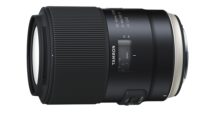

We wish to notify you that we will perform updating of the firmware for our SP 90mm F/2.8 Di MACRO1:1 VC USD (Model F017) for Canon.
Affected Models
- SP 90mm F/2.8 Di MACRO 1:1 VC USD (Model F017) for Canon
Serial number
Firmware update will not be required for lenses with these serial numbers.
Firmware Improvements
- When used in combination with the Canon EOS 5D Mark IV, behavior where the camera takes several seconds to start up when first switched on after mounting the lens has been improved.
- When used in combination with the Canon EOS 5D Mark IV, behavior where power consumption was high with the lens mounted and where the camera’s battery charge would continue to drain even when the camera was switched off and stowed with the lenses mounted has been improved.
