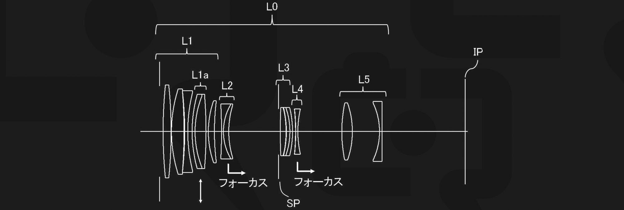

In this patent application (2024-010559), Canon explores some new designs for macro lenses. With the Canon RF 100mm f/2.8L Macro IS USM, any of the longer focal length designs are unlikely to reach production. There is a 50mm 1:1 Macro that would certainly be useful.
All the Macro lenses shown in the embodiments include image stabilization.
You never know if Canon will decide that a smaller version of the 100mm macro is a good idea, and certainly, there is room for the 50mm in Canon's portfolio.
Canon RF 110mm F4.0 1.0x Macro IS
Focal length           111.29
F number                 4.12
Half angle of view (°)  11.00
Image height            21.64
Lens total length      125.00
BF                      34.03
Canon RF 90mm F4.0 1.0x Macro IS
Focal length            90.00
F number                 4.12
Half angle of view (° ) 13.52
Image height            21.64
Lens total length      120.00
BF                      21.58
Canon RF 50mm F4.0 1.0x Macro IS
Focal length            52.00
F number                 4.12
Half-angle (°)          22.59
Image height            21.64
Lens length            115.00
BF                      24.18

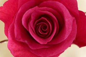

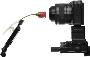

    Larger subjects, typically. The challenge is that with wider macro lenses, the working distance is very short. For example, this shot with the EF-M 28mm Macro was at 1.2:1 (the lens has a 'super-macro' mode):
    The working distance for that magnification is 0.5" / 13mm...
