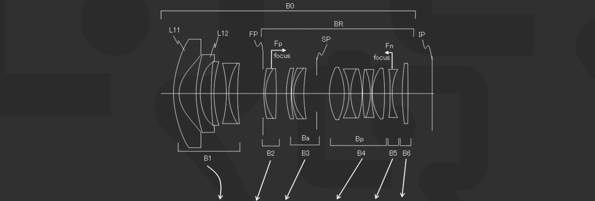

It's been a slow month patent application-wise, unless, as I told Craig earlier, I start to talk about printer patent applications. No one wants to do that – including yours truly.
In this patent application (JP2024-042622), Canon talks about some Ultra-wide full-frame zooms. Now, this is one area of Canon's lens portfolio that is pretty top-notch – so any lens in this patent application would have a difficult time justifying its purpose – but an F2.0 ultra-wide would certainly have its uses if coma was tightly controlled.
All the embodiments are pretty decent with a full image circle even at the ultra-wide end, and while they sit into the camera mount, not excessively so with a 6mm ingress into the mount.
Canon RF 14-20mm F2.0
                Wide  Intermediate   Telephoto
Focal length   14.30      18.00       21.50
F number        2.06       2.06        2.06
angle of view  56.54      50.24       45.18
Image height   21.64      21.64       21.64
Lens length   148.04     141.94      139.46
BF             13.87      16.78       20.30
