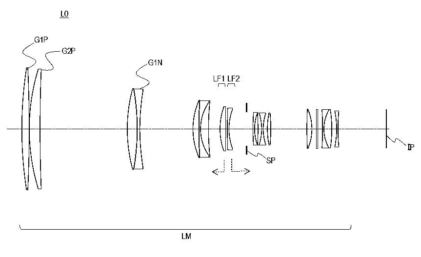

Canon 400mm F2.8L IS USM Extender 1.4x
I've included the element design that animates between the inserted and removed extender. As you can see, the extender slides in after the first element group. This supertelephoto lens can flip between 400mm and 550mm using the built-in 1.4x extender. With a 51.81mm back focus distance, there is ample room to add on an additional external extender as well.
SpecificationWithout ExtenderWith Extender
Focal length389.00  544.00
F-number2.914.19
Half Angle of View (°)3.182.28
Image height21.6421.64
Lens length406.00  406.01
Back Focus Distance53.83  53.83

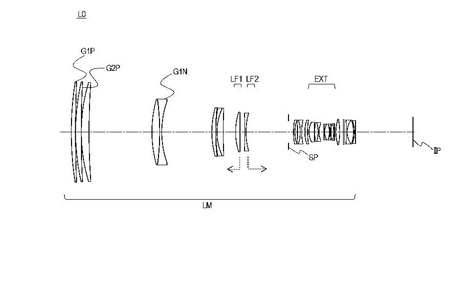

Canon 600mm F4L IS USM Extender 1.4x
This next embodiment shows a 600mm F4L supertelephoto lens with a built-in 1.4x extender, giving you a 600mm and 800mm prime in one lens. I don't think your kidney would cover the purchase of this lens. This lens also shows a 81.91mm back focus distance maknig this design extremely extender friendly for even more reach.
Focal length582.00    814.80
F-number4.125.88
Half Angle of View (°)2.131.52
Lens length486.10  486.10
Back Focus Distance81.91  81.91

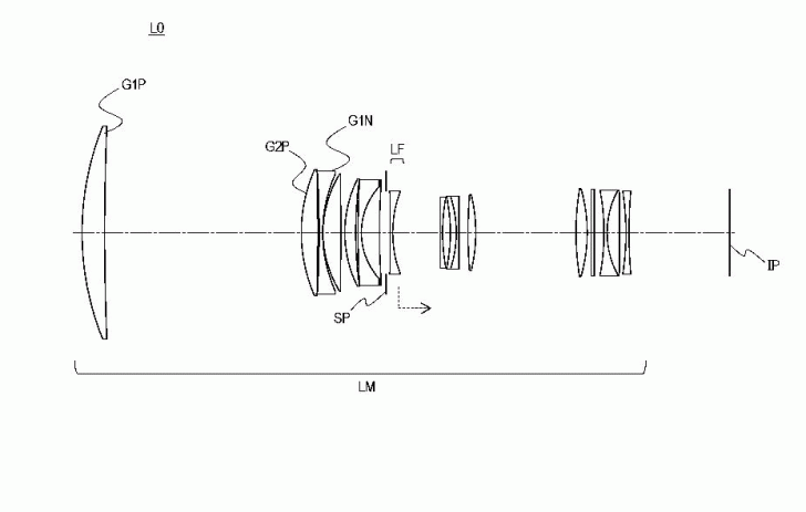

Canon 300mm F2.8L IS USM Extender 1.4x
This embodiment shows a 300mm F2.8 supertelephoto lens with a built in extender giving you a 300mm and 400mm in one lens. As with the other embodiments, with a 49.68mm back focus distance, you'd be able to add on external extenders to get an even longer focal length.
Focal length300.00  420.00
F-number2.914.12
Half Angle of View (°)4.12 2.95
Lens length320.00  320.00
Back Focus Distance49.68  49.68
