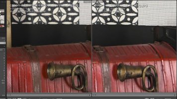

I suspect that there is some field curvature and/or misalignment in these samples. I've attached a crop of the car at the bottom right. Notice how foreground objects are sharper on the Canon and the objected pinned on the background are softer. Unfortunately this means we cannot accurately assess how well the 1D-X Mark-II holds onto detail from these samples alone.
To my eyes they appear to perform very similarly and so I'd say high-ISO noise performance is not a noteworthy difference between these two bodies.
