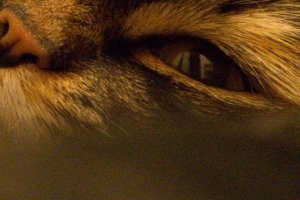

If you are referring to what Sambal Oelek said about the cat at ISO 6400, I'm not sure I agree, but maybe I got you wrong. I'll try to post three 100% crops: one without any NR, one with the default 25 chroma NR, and one with 69 (!) luminance NR without chroma NR, which makes the chroma noise easily distinguishable form the luma noise.

What I was expecting was to see a lot more color noise (chrominance noise or chroma noise for short), similar to filo64's result. Luminance noise is already visible in the jpg (the "graininess" of the OOF areas), so i figured that at least some chroma NR was being applied by the RAW converter.
Thanks to kevl for uploading the file.
