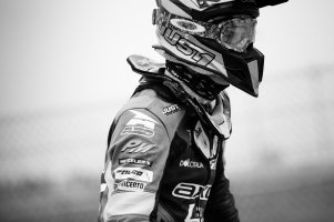

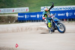

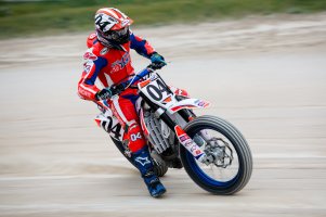

I've attached a few photos I took with the 5D and 70-200 recently in Misano.
