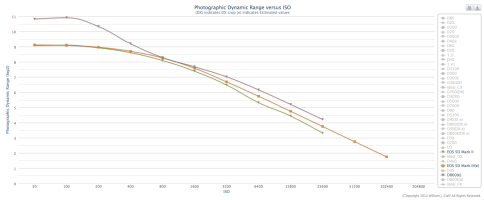

I saw this chart in another thread, and it looks like the D800 is the new DR king for sure.
The 5D3 and D800 are pretty much comparable, but only at ISO800 and above.. Below ISO 800, the D800's DR is heading sky high, setting a new record.

Numbers are hard to interpret, there are so many factors that don't show in a number. No measurement so far I've seen take noise quality (pattern etc) into account, which has a huge impact on subjective DR.
Even if 5Dmk2 and 3 measure the same, if pattern noise is less than usable DR will be better.
High ISO measurements often miss out on quantum efficiency and can be misleading due to that.
A test that I would like to see is mk2 and mk3 shooting the exact same test scene perfectly ETTR, and then push a shadow area (preferably containing a color checker) 3 stops and show the crops side by side, resolution is almost the same so no sacling is required. I suspect/hope that the mk3 will fair much better in such a test than these measurements indicate.
If this chart is true and not a result of some miscalculation, that would indicate that the D800 applies some sort of artificial curve to balance the shadows and highlights. An aggressive HTP sort of thing.
Bill Claff, whose site this is from, is a long-time fervent Nikon guy; and these graphs are based on estimated values for both the D800 and the 5D Mk III.
Big pinch of salt in order here...
KeithR said:
Why is everyone getting all worked up about some guy's GUESS about sensor performance?
