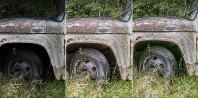

I really wish the mRAW was a viable option to me and am a little disappointed mRAW is so terrible. Is a wedging photographer I would really like to go between 28mp and 50mp to help with file size but a few quick tests showed there is a lot more missing from a mRAW than resolution. Here is a quick test, original on the left, RAW in the middle, and mRAW on the right. Why are the colors so terrible in the shadows? I underexposed the image on purpose and processed it more than I would have if the image served more of a purpose than just a test, but look at the wheel well? The colors in the shadows turned green. What in the world happened? All of the settings were taken the same and all of the post processing sections were the same too.

I really wish the mRAW was a viable option to me and am a little disappointed mRAW is so terrible. ..... a few quick tests showed there is a lot more missing from a mRAW than resolution. Here is a quick test, original on the left, RAW in the middle, and mRAW on the right. Why are the colors so terrible in the shadows? ..... The colors in the shadows turned green. What in the world happened? .....
Definetly looks like a firmware bug. That's crazy, looks like they forgot to average the accumulated luminance between the pixels in the down sample. I'd send that one to Canon for comment so they know of the issue ASAP.

I think you are right, but beside the point. He should be able to use mRAW without the shadows being green.

jaayres20 said:
neuroanatomist said:
Issue with DPP?
I am using Lightroom and ACR. So maybe it will get better with Lightroom updates? I have never installed DPP and probably won't. Personally I have never messed with mRAW in the past with other cameras. Is there normal a difference in terms of IQ?
I thought mRAW only worked well with DPP.
I was hoping that for a certain kinds of less demanding assignments I could use mraw but ended up having tremendous problems fighting those greenish shadows in postproduction. The mraw in 5dsr is an option not to be used unless they do some serious fix which I doubt. It doesn't matter what software is used to convert the raw file. I did a comparison test, photographed a dark brown leather sofa in a dark light in raw and in mraw. In raw the sofa is brown and in mraw is green.
