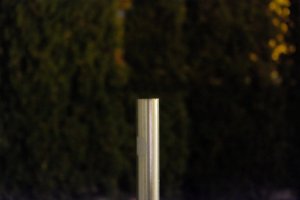

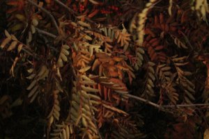

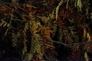

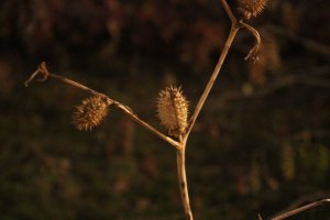

The backyard test subjects were, in order:
1. a galvanized pole reflecting a light source with a dark background in the distance
2. a dried thornapple seed pod with a dark background in the near distance, and the most difficult was
3. a mass of mountain ash twigs and leaves. Images of them below are reduced from the 7d2's ooc jpgs at 1/8 linear scale.

I'd venture they're not sharp because I was well beyond the lowest shutter speed/focal length where the IS is able to deliver. Combine that with medium focal length, relatively shallow DoF, any bit of motion is going to cause some blurring. Add in the level of way late night fatigue I had there was no way I was going to be as steady as I could have been either.
None of the images were sharp, motion blur seems to have gotten most of them far more than the in-camera NR for loss of detail.
The first 2 shots with the 7d2 were at 1/4 second and 70mm - that's between 4 & 5 stops slower than would be recommended as a slowest shutter speed for that focal length to have a reasonable chance of a clear image and likely a stop or 2 beyond what most IS systems can deliver.
The 3rd shot was at 0.4 seconds so nearly 1 stop slower yet. I'm not sure if there was also some breeze-induced motion on the leaves there as some are much more blurred than others. It was just hard to see and judge focus on top of that.

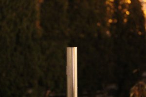

Here's the shots from the Olympus E-M10.
All at 53mm, 1/8s, f/4.4, 12800iso, handheld and set to use the IS of the lens rather than the in-body sensor-based IS. As you can see, the 3rd shot of the leaves was hopelessly OOF while sharpness on the other 2 is better.
Here's the shots from the Fuji X-T1
All at 70.5mm, f/4, 12800iso (Fuji's ISO may be about 1 stop optimistic)
5/13s shutter for the pole
1/3s shutter for the thornapple
1/2s shutter for the leaves
