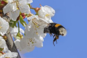

I also moved away from BBF, but on the R5 I set one button to enable single-point AF to get the camera back on track. Last weekend I tried doing BIF with the RF100-500 and was reasonably successful:
20210417 1044 12 Nederland Amersfoort - Canon EOS R5 - RF100-500mm F4.5-7.1 L IS USM at 500 m...jpeg
Most of the time the R5 would track the bee, but it would get confused when it flew in between the cherry blossoms. Pressing the BBF to use small single point would get the focus back to MFD where it needs to be.
The 180L allowed me to get a bit closer, but this really needs the dual nano-USM like the RF100-500 has. Slow bumblebee at these distances gives the AF motors a good workout! The 100L was a bit faster to focus, but waaaaay to short a focal length. I hope the RF100L will get similar AF speeds as the RF100-500 does. And hope for a long-ish 1:1 macro in the 200mm F/4 range with 5 blades triple nano-USM :)
