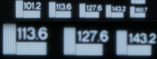

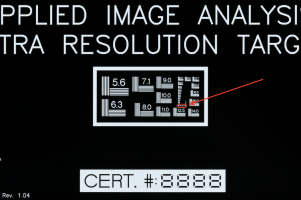

Agree that 2400mm f/25 is not useful on a modern high-resolution body. You should consider that the 150-600mm zooms essentially have a 1.4x TC built-in to get from 400mm to 600mm, so just putting a TC on it is essentially stacking TCs (not exactly, but close enough to practical reality).
