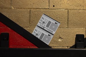

Back home from an inspiring photography conference. Here are the comparison photos I took of my 400 DO ii and an RF 400/2.8L from the Canon stand.
Test conditions
- Constant lighting conditions.
- A gimbal on a sturdy tripod, shot at two distances. The photos discussed here were at the longer distance, back calculated to be about 10m.
- Auto focused using one shot focus on a double Bob Atkins chart.
- IS set at mode 3.
- 2 second self-timer

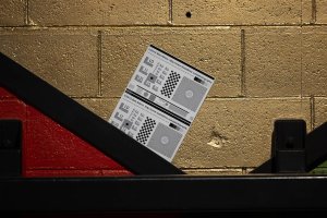

- ISO 100 and 400 - I used 400 as there seemed to be a little motion blur at ISO 100. Exposures were 400 DO: 1/60 @ f/4, 400/2.8: 1/125 @ f/2.8
- Aperture priority set at wide open - I also shot the 400/2.8 at f/4.
- CRaw files imported into Lightroom Classic with no corrections.
- The sharpest of three files for each test selected for comparison.
- Copies were made of these images and the Atkins chart cropped out. Auto white balance set on the chart. Auto exposure on the Atkins chart. White balance and exposure pasted into the original files (3 and 4).

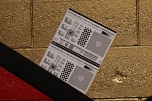

- Auto exposure (of the Atkins chart) gave the 400/2.8 lens +0.5 and the DO lens +0.75. (photos 3-6).
- This might suggest that the DO lens has 0.25 stop less transmissivity, but the full frame 400/2.8 image (4) appears darker than the 400 DO image (3), possibly due to vignetting.

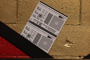

- In terms of sharpness, both lenses have similar resolution, resolving between 5.6 and 6.3 on the test chart - this could be limited by the sensor. However, the 400/2.8 is noticeably crisper. (5 and 6).

1: Full frame DO image out of camera (@f/4)
2: Full frame f/2.8 image out of camera (@ f/2.8)
3: DO image, with exposure and WB balance corrected (see above).

5 and 6: Crops of images 3 and 4.
