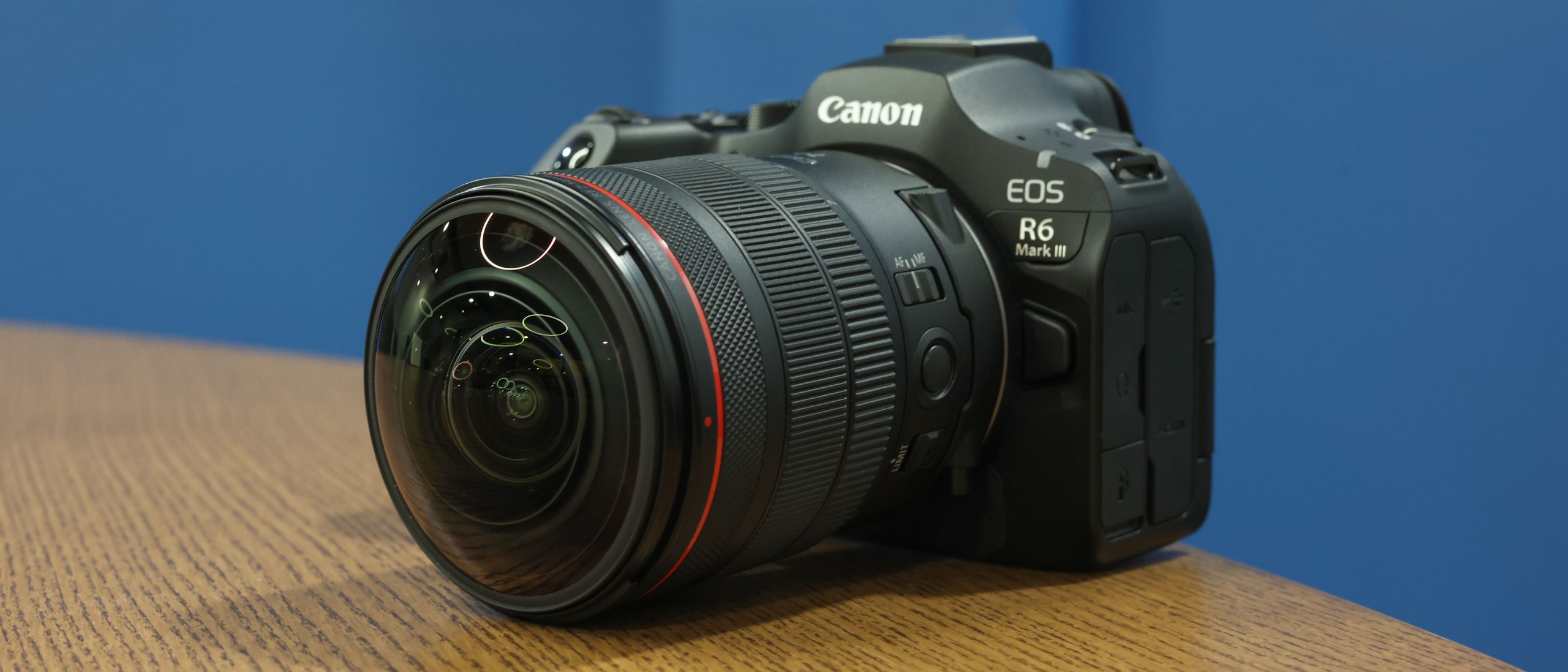

A Canon RF 7-14mm f/2.8-3.5 Fisheye Zoom is Coming Soon
