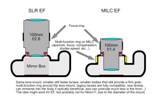

An EF-S-style protrusion - but deeper - into the mirror-box might be possible...
I have entertained this idea for a while, and although I have arguments against it as well, thought it would be at least an interesting discussion topic...
To make it easier to explain, here is a sketch:
This design doesn't help with any of the lens that really matter -- lens that pros who buy $3,000 bodies have -- like a 24-70/2.8 or 70-200/2.8 or 85/1.4 or....
The because the focal flange distance, which is the distance between the sensor and the first glass element cannot be shorter than it is now. This is why Sony GM lenses are longer than Canon EF lenses. If you look inside a GM lens, you'll see that basically the first part is just empty space.
If they made a mount as you propose, all of the pro lenses would start with a first lens element near the mount. The recessed lenses, especially if they recess as far back as you propose and with a lens-to-sensor size ration that you've illustrated, would end up being crop lenses of some kind.
Keep in mind that if you recess a lens, you lose a lot of potential throat diameter, because you still need to protect those first glass elements.
On the other hand, there is no reason at all an MILC couldn't just use EF-S. You could mount your recessed lens... and get a crop camera at a lower megapixel (the image wouldn't cover the whole sensor), just like what you get if you use a APSC lens on a Sony FF.
Whilst this in an interesting idea, like Talys pointed out, I think the throat width would reduce the usefulness somewhat. At the very least, I think it'd rule out fast lenses. Slower lenses may work?
As I said, I also have some counter-arguments...
Especially:
I fully agree with this.
And my sketch indeed shows an unchanged EF geometry, sans mirror.
I do not agree fully with this, however. FF cameras (Leica M, Contax G2, etc... ) have always had lenses where the rear element was just a few millimeters from the film plane. Wide angle primes.
I'm also curious if all those really big Sony FF G Master zooms actually "need" that space in the back, or they are just reworked SLR optical formulas. Comparable Leica M lenses tend to be smaller, at least that's my impression.
My point would be that there is no real need for a change to the EF mount. Some lenses will anyhow be happy with the flange distance, others - and you are right again here: if the throat diameter is sufficient - could reach into the space.
I think about FF only, for APS-C there is the EOS-M, and that's already another universe which, I believe, will fully cannibalize the EF-S line...
Vilmos said:
AFAIK, that was possible because film behaves differently than digital sensors. Film chemistry will react with light hitting it at any angle, while digital sensors need light to hits close to perpendicular, and that requires more distance between the back element and the sensor.
Antono Refa said:
Vilmos said:
More generally speaking, pancakes also benefit from mirrorless size benefits. But the thing is, nobody complains about the total package size with a pancake, right? What we are REALLY wanting are the workhorse primes and zooms that are currently awkwardly large to be smaller.
For example, I choose to upgrade my original 24-70/2.8 to the 24-70/4 over the new 2.8, in part because of IS, but in part because of the attractive size.
If a recessed (or mirrorless) full frame 24-70/2.8 could become the size of a f/4IS package, that would be really interesting -- but I don't believe that's possible.
