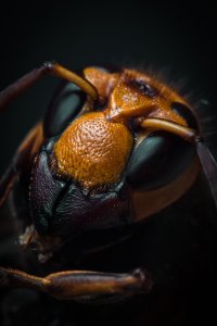

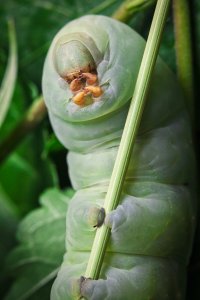

Here are a few pics i took with the kenko tubes and the 5D II + canon 100mm 2.8 USM macro lens.
1. Japanese Hawk Moth Caterpillar (スズメガ)
2. Japanese Giant Killer Hornet (オオスズメバチ)
Lovely!
