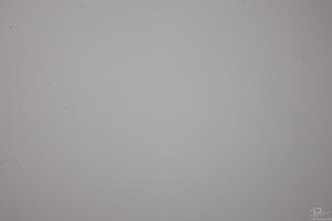

Now, I have a follow-up question. The sensor has a bit of dust, and I know there is no sensor cleaning system.
So should I send it in and get Canon to do it (might also get a replacement screen), or is it something that can be safely attempted by self using a rocket blower (no, I won't go into the stamping/swiping tools)? I have attached a picture of the sensor. Advice will be greatly appreciated.

Hi Sagittariansrock.
I would try blowing, possibly seeing how much junk you have in there I would try a small tube taped to the vacuum cleaner, adjust suction and overload on the motor by leaving part of the taped joint open, place the end just inside the mount to encourage the junk to leave rather than just redistribute it!
May I ask why you won't try a wet clean if it is needed? With a system from one supplier, their swabs and fluid following the instructions you can't really go wrong. I suspect that blowing will remove some but not all dirt, I would not be happy with any dirt on the sensor after cleaning, I was looking at a couple of pics yesterday and had the damn I have dirt , then I realised one was an OOF bird and the other was debris (seaweed?) in the wave splash!
Cheers Graham.
sagittariansrock said:
Hi all,
Thanks.

Thanks RL, Sporgon and Graham
I will try the blower>sensor swab (Why didn't I want to try this? Because I'm skittish)>Canon, unless I decide for the Ee-S sooner, in which case I might just send it in.
