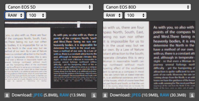

I have printed hundreds of prints for dozens of photographers and in my experience sensor size is more important than pixel numbers when printing big,
Here's a 12mp 5D FF vs a 24mp 80D crop. There's zero question as to which enlarges better or which could handle more cropping, and it isn't the 5D.

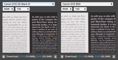

Now here's a 22mp 5D3 FF vs a 24mp 80D crop. About the same despite the sensor size difference (or the slight MP difference).

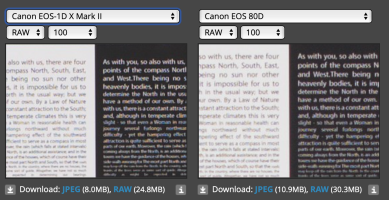

On a very practical level an 80D will not print as large as a 1DX MkII, well not to my or the photographers I print for eyes.
Of course it will at low ISO. In my experience when post processing crop needs a little more sharpening than FF, but that barely shows here:
Now if all your tests were done at high ISO that would explain it. At high ISO FF is cleaner and retains more sharpness and fine detail.
