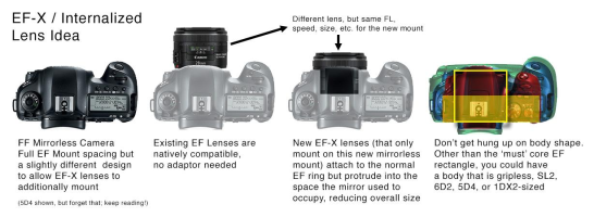

A moving sensor solves the flange distance problem but not the EF-RF mount incompatibility.
When I 'predicted' it, it was way befor the R release and we didn't know anything about the mount compatibility. Btw I also predicted the moving sensor could also be tilting:
But tbh I'm not sure if I believe this current rumour. If Canon releases such a camera, they end up with a zoo of strange chimeras. But at the same time I'd probably buy it, providing the camera delivers desired specs.
If this rumor is true, which I hope it isn't, why is Canon wasting their time on a hybrid mount. Get a pro mirrorless body for sports to market already! I've been a Canon user since January 2004, and since then I've owned a 10D, 20D, 30D, 40D, 7D MII, and 1DX, but I'm about to jump ship to Sony. If my Quantum Trio flashes worked in TTL/Auto on a Sony I'd already would have made the switch. I like my 7D MII, love my 1DX, but it's a tank. The Trio's are exceptional in the field, even when using bare bulb, and I use at least 1 Trio on 90% of my shoots. IMO, Canon has totally missed the field in the mirrorless game.
I like the 'sensor on rails' innovation, but there is still the physical mount diameter difference between EF & RF. Maybe a new 'pro' mirrorless would be bundled with a new RF to EF adaptor that includes the EF200-400L f4 style switch in & out 1.4x Extender. This would make a move to mirrorless more attractive to EF 'white ' lens users.

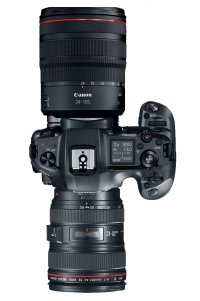

After looking at the EF and RF mount carefully, I have a difficult time envisioning modification to the mount that would retain adequate strength and line up the contacts. It might be possible to modify the mount to accept both, but I don't see it as practical, perhaps some sort of design that rotated mounting slots, but a Rube Goldberg mount is not for a 1 series camera.
As far as diameters, both EF and RF are the same. The best way might be to mount a RF lens upside down so it matched with a 2nd set of contacts. The question is having adequate mounting strength with a dual mounting setup.
If a mount can be designed, then a collapsible mount or moving sensor would work.
There may be such a beast out there as a prototype, but as to actually producing it??
In any event, the physical design of the camera is locked down by now, and production of the pieces and parts well underway.
Yeah, the obvious solution from an engineering perspective that everyone seems to be missing so far is this:
Interchangeable digital back: a shallow one for RF and a second, a deeper one, for EF flange distance.
This coupled with a universal bayonet Mount combining both EF and RF. No moving parts no floating sensor. Weather protection isn’t an issue.
