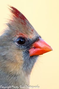

Do yall ever use flash? I was thinking that setting up a wireless umbrella/680ex rt set up to do high speed sync would be a good way to go about shooting birds... but then I REALLY don't want bird crap on my flash or umbrella.
I have. I set it on a small table about 8' from the bird feeders. They get no where close to it. The shot I included was with a glass. It really helps to bring out the details in the bird.

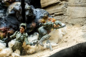

About week ago I was shooting through a glass display case (actually probably plastic). Mostly I tried to shoot directly in, but some shots I had to shoot angled to get the angle I wanted. E.g. this one, about 45 degree angle on the glass:
