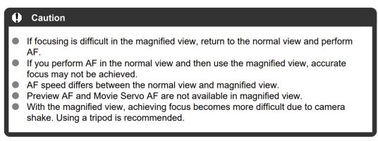

Several things going here, but I was trying to do things this way. Moving between magnified view and normal view was definitely causing me issues, and a third dynamic not mentioned here was moving between the viewfinder and the screen while going in and out of magnified view.

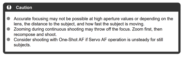

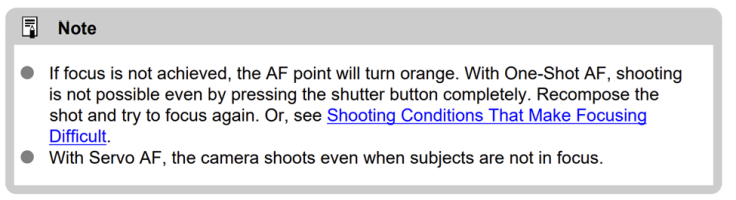

1642108117350.pngSo, it would appear I may be using some of these "certain [but unspecified] lenses"? I experienced focusing problems while using my Canon primes, notably the Canon RF 50mm f/1.2; the Canon EF 100mm f/2.8; and, the Canon EF 85mm f/1.4 . What certain lenses is Canon talking about?

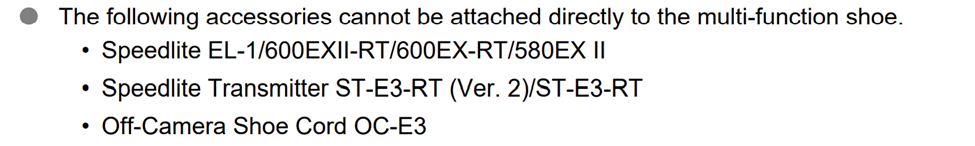

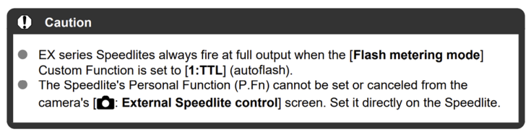

Further to my flash experiences, the Canon R3 manual notes:
I really do not know how to interpret this, because I am able to physically attach my Canon 600EX-RT to the multi-function shoe, but it either does not fire, or it fires improperly, when done. A youtube video featuring Rudy from Canon USA seems to suggest otherwise - that it can be supported, and others appear to not have any issues? Yet, perhaps a setting (unknown to me) deep within the menu system may have been impacting things for me. I have not yet had a chance to visit the menu behind this caution below, but I will let you know if this was the issue at hand. I normally shoot in manual mode, but I was trying to test things in TTL as well.

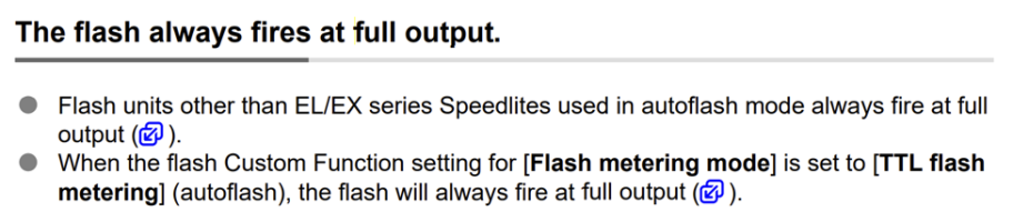

Yet, I also came across this note, and I did experience full output bursts with my Godox AD400 Pro strobe set in auto TTL through my Godox XPro transmitter.

Really not sure why the manual says that. But it’s not true.
The flash custom setting that forces full power is TTL metering. We’re on E-TTL II metering now, which superseded E-TTL which replaced TTL. TTL was what film cameras used, the preflash literally bounced off the surface of the film onto a sensor that determined flash exposure. Seems reasonable that forcing your flash to use a metering method from 1987 would muck things up.
You may want to reset all the flash custom function settings on your 600EX and try again. I tested all 4 of mine, all work just as on my 1D X.

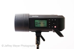

For example, I had a wicked time trying to photograph my Godox AD400Pro (pictured below) for an online ad sale that I was preparing. While using single point, one shot AF mode, my R3 could simply not focus on this sucker, and with a bit of creativity I can now see why because it's almost shaped akin to the horizontal black line in Tony's video. My work around was to ultimately focus on something else nearby (that was not black), then pivot my camera over. Even trying to focus on the word Godox, or the menu buttons, proved incredibly tough. Big picture, I'm now getting up to speed on how mirrorless technology is different than what I am accustomed to, and I now need to think about contrast and lines differently. In the end I suppose I was just ignorant about such things earlier in my photography, so shame on me. For better or worse, one of the key selling features of the R3 for me was that it had almost the same shape and layout as my 1Dx, and I've always liked how that fit in my hand. And, being newer than my 10-year old camera, I just naturally assumed that it would be better in every possible way. Turns out that assumption may not have been entirely clear and true. Thankfully, the results from my new RF 50mm 1.2L lens (when it does nail the focus) prompt me to keep giving this stuff a chance.
For the moment, all my focusing issues may boil down to a combination of old working practices (that may be causing conflicts) and camera settings (that may also be causing conflicts yet unknown to me). That would be great news. Yet, the sensor details noted by you guys and others is a big deal, and I'll just need to relearn how to frame things for easier focusing. Yet, if it does turn out that I do have hardware/software oriented issues with my R3, then at least I'll now have a warranty plan for covering them. Cheers, Jeff

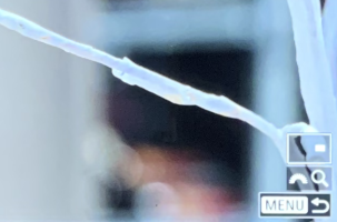

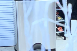

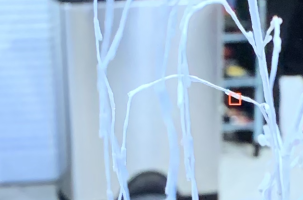

It still seems to me your AF issues are beyond what I've seen in both my EOS R and my R3. I have no trouble focusing on a subject in front of (or an ornament hanging on) a Christmas tree with color-flashing LED lights. I have no trouble focusing on close subjects with a busy background. There are a couple of examples from my EOS R in the mushroom thread, and some with the R3 below.
I just spent a few minutes in my mudroom and utility room with my R3 + RF 24-105/4L focusing all over the place. Near and far objects, text on paint cans, duffel bags in the nearly dark area under a work table, the dangling branches of a not-yet-stored outdoor LED willow tree holiday decoration, the wine rack behind the branches of that willow, etc. Somewhere close to 300 focusing attempts, and it only failed to achieve focus on two subjects. One was a set of louvered closet doors, the other were the upper and lower borders of a chalkboard-paint rectangle on the door to the garage. Both of those have contrast exclusively in the horizontal direction. In both cases, using the smart controller to slide the AF point over a bit (to the sides of the chalkboard rectangle or some of the text written on it, or to the vertical edges of the closet doors) allowed focus to be achieved. Rotating the camera would have done the same thing.
That quick test matches my real-world experience with the R3 – it almost never fails to focus except in that one specific situation of horizontal-only contrast. In a way, it's life coming full circle...when I started shooting with film cameras, the best way to achieve critical focus was the split prism in the middle of the focusing screen. Since the split was horizontal (like the split microlenses on Canon's dual pixels), a perfectly horizontal line could not be used for focusing.
I took a few pictures (with apologies again for the iPhone pics of the camera's LCD) to illustrate my point about the willow branches, since your point #3 specifically mentions struggling with layered subjects. There was no struggle here. I slid the AF point (spot AF) to a branch and focus locked immediately, then I slid it between the branches to the wine rack in the background, and focus locked immediately. Shown are the full images with the AF point displayed, and the magnified focused area for each shot. The louvered door on the left side is one of the subjects where focus cannot be achieved (with the camera horizontally level).
Screen Shot 2022-01-14 at 10.10.28 AM.png Screen Shot 2022-01-14 at 10.10.38 AM.png
Screen Shot 2022-01-14 at 10.10.48 AM.png Screen Shot 2022-01-14 at 10.10.56 AM.png

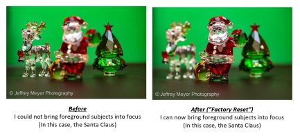

  • My Canon EF 100mm is now performing great on macro-oriented work. I revisited some of the product shots that I was trying to take for fun around my home, and I’m now nailing them on the first pass – even in ridiculously low ambient light. I’m also accomplishing that without tilting my camera like I have some kind of nervous zombie twitch. The one thing I was not able to photograph again was the tips of a daisy petal, as the plant died and is no longer in the house. I will try to pick up another one shortly, but I can now visualize why I might have had trouble with that particular topic.
  • I can now intuitively focus between background and foreground subjects, or nearby objects. Here’s a pic that shows several things I was trying to do, but now can after the factory reset. Yet, I have noticed a pattern on several Canon Rumors posts, as well as in YouTube videos, where people are raising consistent concerns about photographing nearby objects. So, that is something that may now be harder to do for reasons beyond me, but right now I'm nailing the things I want to nail after the factory reset.

  • For example, another past issue that I had, but no longer apparently do, was my focusing point would sometimes drift, or pop up erratically on things that I was not focusing on (or wanted to focus on), and when it did that it tended to most always drift downwards towards the bottom middle, or bottom corner of the viewfinder. That is no longer occurring, at all, and my center focusing point is now more consistently behaving like a center point. When I turn the Servo on it also appears to be now tracking the eyes more consistently too. One thing new that I'm now doing is turning the focus tracking off when I'm not working with eyes. But, as an aside, while I was macro focusing the Santa Claus figurine pictured above my camera still detected its eyes, so I'm a bit confused on why that happened if I had the "none" option enabled, but cool that I suppose it did, as its eyes were very tiny, and ultimately it was correct.
Finally
  • I’d like to extend a big thank you to neuroanatomist and unfocused for their support and insights in helping me out. After I factory reset my R3, I then setup my camera the same way neuroanatomist did, and that’s worked for me too. You can find their setup details under this gear talk section. All very helpful and friendly. I hope I didn't jinx myself here, but for the moment things appear better after at not so good honeymoon.

Regarding flash compatibility, I think it’s either an error in the manual, Canon being pedantic since the weather-sealed flashes aren’t fully compatible (not weather sealed), or a blatant attempt to get people to spend money on the adapter.
The R3 specs at Canon Europe list the sealed flashes like the 600 as compatible, with the notation that the adapter is needed for weather sealing:
As I said, my 600’s work just fine directly in the hotshoe.
