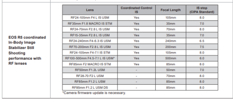

Per Canon spec on the applicable lens pages and then here for IBIS...
15-35/2.8 has 5 w/IS, and 7 w/IS+IBIS
50/1.2 has no IS, and 7 w/IBIS
85/1.2 has no IS, and 8 w/IBIS
70-200/2.8 has 5 w/IS, and 7.5 w/IS+IBIS
100-500/4.5-7.1 has 5 stops w/IS, and 6 w/IS+IBIS
So comparing just about any lens to the 100-500 supports your theory... but comparing others such as the 15-35 > 70-200 or the 50 > 85 doesn't. It would be nice to see the data points on other long lenses.

For the first part, I realize it was a generalization... however, after seeing the data, I can't say I agree (for at least the RF lenses). In all the examples I semi-randomly picked out, they all start with either 5 stops of correction or none. The amount that IBIS added changed... with longer focal lengths getting more stops of correction from IBIS than the shorter counterparts (with the exception of the 100-500).
