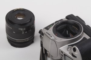

The more I think about the original title question, the more I come to the classic engineering answer ie: it depends...
Best for what? Strongest, lightest, most thermally stable, most rustproof, most bombproof or... cheapest...
As an aside, I had a look at a 18-55 kit lens and it looks like it is ABS plastic all aroud. That would seem like a good material as it is quite stiff, has high impact resistance and is easily moulded to good precisions.
Personally, I would not mind having plastic mount (not bayonet) designed as a fuse, but I also concede that 'made to break easily at the mount to prevent internal damage if hit' won't make for a strong marketing punchline.
