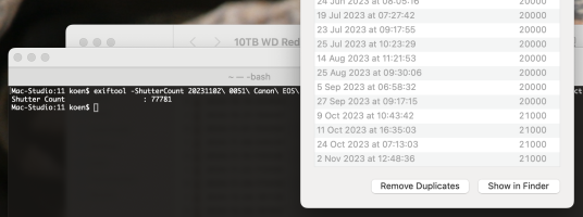

Which camera do you need it for? Exiftool supports reading the shutter count from EXIF for the R6 and R5, which would avoid the need for uploading images to some random website.

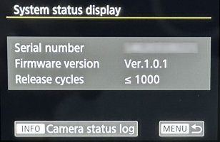

Some cameras, e.g. 1-series cameras and the R3, display the shutter count right in the camera menus, under System Status Display. This is from my R1.
The camera only counts manual/EFCS actuations, not ES actuations – my R3 also shows ≤1000 since I use it exclusively in electronic shutter. My R8 does not have this menu option, not sure about 5-series bodies but it may be a feature reserved for the top shelf cameras.
