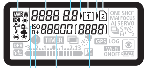

Top LCD Display
Canon chose form over function with its current configuration. It displays minimal information and is often harder to read. It looks new and sexy (and has cool animations while you toggle modes), but in use its utility pales in comparison to a DSLR top display. From manuals to illustrate:
On a 5DIV I can see everything with one glance. On the R5 only my exposure settings are shown, for some reason ISO is smaller/more difficult to see (I care about that setting as much as aperture/shutter), and a button press is required to toggle to a second page with more info. It's just too slow compared to pressing the shutter half-way to wake the back LCD and seeing all the info there. Further, if you're used to a 5D, here are the settings you still won't be able to see at all from the top display:
  • Remaining shots left before card is full (big omission IMO)
  • If multiple exposure is on
  • If dual-pixel raw is on
  • If GPS is on
If you're comparing the R5 with the R6, and the top LCD is pulling you to the R5, don't let it. That said, if Canon improved this, or better yet made it user-customizable with what info can be shown and how condensed, I'd change my tune.
