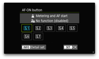

Hey Josh,
How on earth did you do this, because on my R1 that seems to be impossible. When I go to customize the AF-ON button there are 7 options available for selection all of them can be customized but all of them have either the half press or the full press locked. Meaning you can only ever change one option.
Its quite easy to set this up: First first go to ''Customize Buttons for Shooting' in the green menu, the scroll and select the 'AF-ON' button and select that. Then select option 6 in your screen shot above and press 'Info Detail set'. Then set half press to Metering and AF start. Should be greyed out already and Full press to 'Switch ES Cont. Shooting modes' and press 'Info Detail Set' and then select High Speed Continuous. This will give you half press for your current frame rate and full press to 40 FPS. If you need screen shots let me know. I did a video here: https://www.dropbox.com/scl/fo/e1p6...yph44FoM?rlkey=ogsq1qzsx4u45dubrliwekjbp&dl=0
