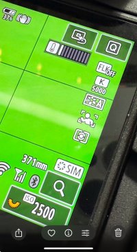

I have to say the firmware feels like it has a bit of bugs left in it. I had a situation durring the game where I had switched into my C2 custom shooting mode and was trying to switch out of it but the camera would not do it. It kept showing on screen that it was transferring an image. So I had to restart it once or twice. In the middle of the second half a temperate icon can up in the viewfinder. It had a little thermometer and to the right of it a bunch empty bars. It was strange because the camera was not at all warm. The icon remained there for the rest of the match, it even went up one bar at one point before going back down to zero. You can see it in the attached image.
