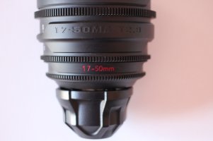

can I use my pl lens on my camera?
I assume that you are asking if the lens will mount to the camera using a Arri PL to EOS adapter?
It should mount, but mirror clearance needs to be double checked, one of the video forums would be a better place too ask. As long as the lens or adapter does not protrude into the mirror box, it will be ok.
I expect the lens is not FF, so you probably will not get full coverage of the frame, or the edges and corners will be poor.
