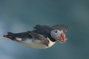

This award winning picture, soon to be displayed in the British Museum of Natural History exhibit has the main focus point on the krill and not the eye. Taken with the 7DMII and EF 100-400 II.

So, did the photographer focus on the krill on purpose or was it pure luck? I’m guessing the latter. Maybe the photographer can chime in. Great shot!

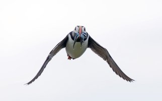

Was that one of your European shots? Very, very nice indeed with krill. Here's a Farne one focussed on the eyes of the more usual sandeels (5DIV + 400mm DO II). Do you think eye AF would have picked them up? Wish I had your blue sky in the background.

The key point is that if the camera had focussed on the eye, the krill would have been out of focus.

Like a DO f/11:). These puffins move so damn fast it's all you can do to keep up with them.
Exactly! I’m struggling just to keep passing shots, like these fast puffins, in the frame, let alone pick the exact focus point. A camera that could choose the eye to focus on would sure help me.

I have a series of shots of the bird as it flew by and with all of them sharp in the sequence (that's essentially a full frame shot--just a sliver cropped off the top), I generally try to focus on a part of the bird that is in the same plane as the eye but in this frame the bird's head was slightly behind and the servo focus caught the beak and krill.

Picture was taken at dusk at ISO 800, f/5.6, 1/500

Lovely picture, as is Alans but the evening glow in yours is special.
I love Puffins !
Thanks so much but it's very noisy because I was really fighting the ISO vs speed because I'm am an ancient LOL and the 7D + 100-400 is the heaviest thing I can carry and still get where I'm going so I shoot all handheld. If I had to carry a tripod and heavier lens I'd never be able to schlep all the stuff to the birds/animals to photograph them. I'm just hoping that with the extra megapixels, the extender, and the better ISO I'll be able to eke out a little bit better pictures with the R5. I think I've about milked the 7DMkII as much as I can. I've been using the R for some birding and like it for larger bird scenes. I just had another one of my bird pictures come out in the Audubon Top 100 this week and so did a guy that posts here who shot his with an R (gorgeous tropic bird in flight) He's much more successful than I am with the R, but I think that it can be quite good for the first couple of shots. It's just the tracking that's difficult with the EVF. I do like it and if the R5 improves that (which all indications are that it does), it should be great for me.
