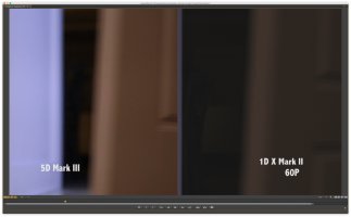

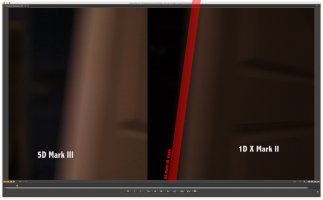

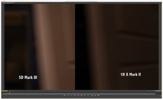

**edited with an additional explanation of results.
This is a test using a opening and closing door with cameras positioned one over the other at the same vertical angle. Please forgive me for doing this so crudely; it isn't pretty, but it's good enough for me.
The six images show the results I found. The first four are images at 23.976fps, 4K MJPG on the 1DX Mark II next to 23.976 1080 All-I on the Canon 5D Mark III. I included a red line from the 5D III next to the 1DX to show the difference.
The final two images are comparisons with the 1DX Mark II at 60p. The relative difference and improvement in rolling shutter to the 5D Mark III appears to be the same either at 24p or 60p. I was surprised to see that the difference to the 5D is not that much.
**the difference in slope is more pronounced at times because I was not opening and closing the door each time at the same speed, and I tended to swing it faster in one direction due to my positioning. --thanks for understanding!
I'm attaching six images showing new tests I made. The first four are images at 23.976fps, 4K MJPG on the 1DX Mark II next to 23.976 1080 All-I on the Canon 5D Mark III. I included a red line from the 5D III next to the 1DX to show the difference.
Thanks for sharing, much appreciated.
I'm confused why the sensor readout time would change at all when switching from 24p/30p/60p.
I would assume the sensor readout time would be constant at the given resolution (1080p or 4k) and the change would be the interval of how often a readout is taken (to determine 24p/30p/60p). Is this not the case?
