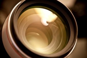

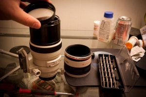

I have to be the exception I guess, I own a 100-400 and mine got pretty dusty in the 3 years I have owned it. however, I never experienced any undue dust on my sensor, just the lens elements. It got to be so much that I started to get a haze on my daytime photos.
I solved that last night.
I am now dust free on my 1st 2 elements, I didn't want to go further because it just would have been a technical nightmare. This lens is much more simple than it seems.
BTW, I bought this thing on craigslist, I had no warranty or service contracts. I am proficient with electro-mechanical repair, and did not go into this blind. So save me the "You're a fool to do this" I recorded the calibration of the 1st element and retested after reassembly. Every thing is in working order and is in fact smoother than before, due to some long overdue re-lubing and cleaning.
