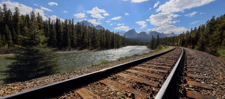

Another question/comment. I'm only using DPP so far and the lighting at Lake Louise was very challenging. I have the DPP highlight max down and the shadows max up. Even then I have those deep shadows and I might even have dropped the contrast one tick. Should I be on tripod and trying HDR? Or would that just look artificial?

Having never used DPP software, I can't really give advice on how to edit in it. Does DPP have the ability to use graduated and radial filters? I find them to be indispensable with this lens, as it can't take normal polarizers or ND filters. They allow me to make subtle changes to specific areas of an image, such as the sky, or a certain point of interest midframe, for example.
You could also certainly try using a tripod and taking multiple exposures for an HDR image to help with the darkest shadows in the scene. You can usually blend multiple exposures so they don't look "HDR". I find people tend to use an HDR preset in some software suite, and that's why HDR looks dreadful -- colors become way too vivid, and shadow areas are suddenly way overexposed.

I like your shot with the train tracks the most, the sun bursting into the frame from the top is a great idea beautifully executed.
Lowering the Contrast in DPP to -1 gives you more detail in the highlights and hardly affects shadows. To raise the shadows you have to adjust contrast to -2. This will lighten your shadows without really affecting the highlights any further than -1. I wouldnt go further than -2 because it will likely look unnatural/flat. When adjusting highlights and shadows seperately in DPP i try to avoid values that exceed the -2 to +2 range because you will not gain more highlight/shadow detail and mess up your gamma-curve. You can easily observe the effects in the gamma-settings part. Any adjustment that goes beyond straightening the curve usually looks artificial and makes your image weaker.
But I think your problem is not dynamic range.You have chosen to have your sky with a deep and saturated blue, which is achieved by lowering exposure / underexposing. In my opinion it is not very natural to have a deep blue around the sun. The deep / saturated blue sky is mostly seen when looking away from the sun. If you like it that way, thats cool. But why not give it a try and raise your exposure. This will brighten your sky and give you more shadow detail while still looking natural. Try not to blow out your sky and keep some gradation/color information. Enabling auto lighting optimizer will also be a great help in achieving this - if you havent used it already. In your particular shot I would set it to strong without hesitation.
Give it a try and see how you like it.
Photoguy, thanks for the specific feedback.
"Enabling auto lighting optimizer will also be a great help in achieving this - if you havent used it already. In your particular shot I would set it to strong without hesitation."
I haven't used it in this set of shots - forgot about it.
I'd say that it is not possible with the exposure I used in most of these shots to not be pushing the highlight/shadows to their extreme ends but I will gladly try a few things and re-post a sample of the railroad track.
Personally, that shot was an attempt to include the sun burst, although it was very strong and to try to lead the eye via the tracks to the mountains but clearly having the sun at that angle presents problems. A while back I bought and read The Photographer's Eye, which I should re-read and I'm just trying whatever comes to mind but I'm so untrained.
R1-7D, DPP can't do anything that localizes areas other than the stamping tool for dust etc. I haven't moved up due to the time investment required to learn new software and because I believe the bare minimal functions in DPP that are lens specific are actually quite impressive. For example with the 11-22 Peripheral Illumination works well.
I've heard mixed reviews about DPP but for what it is I like it.
I really appreciate anyone chiming in with opinions. Comments will be somewhat subjective/vary from person to person but anyone with experience is going to be miles ahead of me in their evaluation. There is no substitute for ego bursting as far as learning goes even if it doesn't feel good.

OK, for those interested in this shot's potential/shortcomings I've taken it back to essentially unedited on exposure etc. It is cropped a very little on the right (maybe 5%) to remove nothingness and to go to 16:9.
This was a brief holiday with relatives from NY so I couldn't take time to hike the tracks etc. to get preferred composition such as the curvature of the tracks, time of day and so forth. As it was I'd slid down a pretty steep embankment just to get on the tracks. If you haven't been to Banff and are able some day, DO IT!
6D, 11-24 @11, 1/400, F22 for DOF, ISO 640, EXP +1 2/3 pulled back to - 1/3 but now at 0, shadow +5 now 0, HL -5 now 0, no NR, contrast 0, slight color adj. now removed, Peripheral Illumination - on, default sharpening at 3 but lens specific at 65% ( a default I've used consistently with the 300 2.8 II, no other explanation). As mentioned previously I manually removed some of the chromatic flare, more for the fun of seeing what I could do with just DPP.

Jack as we have talked before and I know you won't take offense here is my edit/suggestion.
I went this route like this, read internal dialogue!
What is the story? To me it is the railroad and the river and their juxtaposition with the mountains. Does the sun or sky add to the image, is it a balancing compositional element? Not really, the extreme brightness on the edge of the frame is more a distraction than a key element to 'the story'. In that case it becomes obvious to lose the sun and sky hence the hard letterbox crop.
Now to tell the story, bring back the blue in the sky, control overall highlights and shadows. Then put a curves layer on and mask it, then paint in the important bits, the railroad and the tree lines, they now give you very strong lead in lines to the heart of the story, the majestic mountains that are not lost because of the size of the sky.
Not sure if you agree, but I think it is a much stronger image now. If you are interested I can give you the breakdown on the adjustments, though apart from the crop I'm not too sure how well they will show up i the browsers.

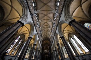

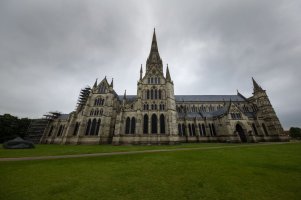

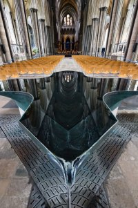

Sorry I've been away from the thread for a few days exploring. I saw one of the four copies of Magna Carta the other day at the Salisbury Cathedral, which was amazing. Also made it up to Stonehenge, but alas, no shots with the 11-24 there. :(
Here's a few shots from the cathedral.
