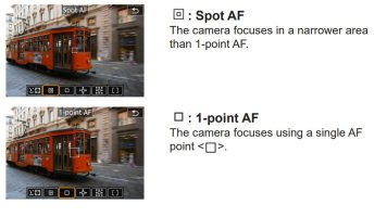

On my 7D2, you can select an individual AF point from any of the AF points, but the spot AF point is only the one centre point. Are we talking about spot AF or single point AF?
They're taking about the size of the actual box that is the AF point. On the RP, there is the "standard" size box (1-Point AF), which let's say for example at a given distance is the size of a person's whole nose when standing 5 feet away. But the RP also has another autofocus method called "Spot AF" which is a tiny little square, that at the same distance might only be the size of an eye's pupil. That "Spot AF" allows for very precise autofocus on a tiny part of the subject. The posts above are referencing the fact that the tiny box is not available on the R, only the RP at this point.
unfocused
Jul 20, 2010
7,184
5,484
70
Springfield, IL
www.thecuriouseye.com
Correct. And I just checked my 7DII and you can move the Spot AF point anywhere you can move the single AF point.
As you know, I am an idiot on the technical side of things. I reckon I am talking about single point and they are talking about spot AF... which I have not missed since I didn't know the difference anyway. :p With 5655 AF points on the R, how small would "spot AF" actually be? It seems moot to me.
Ozarker
Jan 28, 2015
5,935
4,337
The Ozarks
At that distance, I cannot see what difference it would make at all. It might make a difference, but I wouldn't be able to tell. There's more than a single AF point in both examples if that is from an RP.
I don't know about the RP, but with DSLRs it is very helpful when trying to focus on the eye of a bird, rather than just the head.
On my 7D Mark II, any of the 65 AF points can be used in 'Spot AF' mode.
Except the actual area of sensitivity for AF "points" are much larger than the boxes you see in the viewfinder.
It is true that the area of sensitivity is smaller for 'Spot AF' than for '1-point AF', but neither are the actual size of the little squares you see in the viewfinder.
Can you set Spot AF to track a subject on the RP?
EDIT: I use Face/Eye detect with my RP with servo AF tracking enabled, but when there is no face in the frame, the autofocus box used is the size of the 1-Pt AF box described in your post above (which works tracking subjects). Within these schema, is there a way to make the "subject tracking" box the size of the Spot AF box rather than the 1-Pt AF box? Sorry if I'm using incorrect terminology - long day editing wedding photos.
Your terminology is perfect! With both 1-pt AF and and Spot AF, there is no tracking. For tracking I mostly use Face / Eye detect as you described. That works really well in most situations. If the subject is mostly centered in the frame OR I like having a static "focus framing box" (I made that term up) I like Zone AF, which puts a nice large white box in the middle of the frame (but smaller than the whole frame) which it will then choose what to focus on within that large white box.
But to answer your question directly, the tiny "Spot AF" box remains stationary once you set it. You need to either move the camera to point the box somewhere else on your subject, or move the AF box with your finger on the touch screen.
