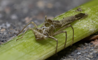

My focus rail arrived last week, still getting up to speed on 'best practices'. An M6II+MP-E+MR14 is very hit and miss currently, I think I need to practice on a less complex subject. The damselfly exuvia have a lot of overlapping sections that are hard to stack.

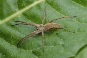

That's why I prefer to use the in-camera focus bracketing with my EF 100mm f/2.8 L IS USM lens because it has an efficient AF and IS. It's magnification does not match the MP-E 65, of course, but extension tubes can help if necessary. If it isn't windy and you can hold still enough, the R7's in-camera focus bracketing can deliver stunning results just the easy way. Best strategy is to reduce the number of stacking images and width of the bracketing depth to a minimum you really need - images that are completely sharp from front to back don't look very natural anyway. Here is an example, a nursery web spider (Pisaura mirabilis): Listspinne Wagbachniederung 30-04-2024 small res.JPG
