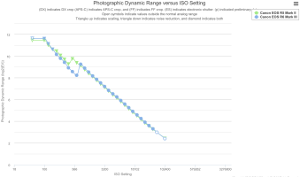

If you want better noise performance, you need a bigger sensor. For those who understand the relevant concepts, there’s not much more to discuss. The 20% increase in pixel density will make zero difference. BSI will make zero difference.
The R5II has a much higher pixel density than the R6III, the noise performance is the same.
A larger sensor has less image noise, because it gathers more total light. Crop down the R5II to APS-C size, you lose DR (because of increased image noise), and what you get is essentially the same as the R7.

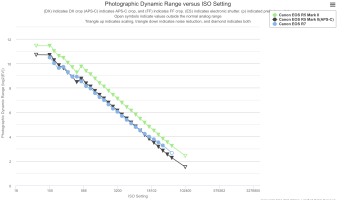

No, we don't agree on that. For an individual pixel, smaller means more noise, sure. People who measurebate pixels love discussing that. People who take pictures care about image noise. Image noise is fundamentally independent of pixel size, but rather depends on total light gathered, which is determined by the area of the image sensor, not the number of pixels packed into that sensor. Divide a FF sensor into 45 million pixels or 24 million pixels, the total light gathered is the same.
With a BSI chip however (or even a stacked chip - if the rumours are true), that technology improves the ability to collect more light. However if the net overall performance gain between the increased pixel count and the BSI technology offsets in still no improvement in noise figure, then Canon missed an opportuniy to improve the camera overall. Had they kept the pixel density the same as the original 32MP sensor, then with the addition of the BSI technology, there would have been a much needed improvement in noise figure.
At the pixel sizes relevant for APS-C and FF sensors, BSI makes effectively no difference in noise. BSI was developed to enable packing more pixels into smartphone-sized camera sensors while maintaining acceptable image quality. With pixel sizes <2 µm, the benefit of BSI is meaningful. In the 2-3 µm range, the effect is marginal at best, and >3 µm BSI is effectively a marketing slogan.

Yes, evidently. The concepts you are fixated on are applicable to pixels, not to pictures. Image noise is inversely proportional to total light gathered. Total light gathered is dependent on the area of the sensor, and independent of pixel size.

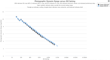

The R7 and R10 were released at the same time, according to your mistaken belief the 24 MP R10 has larger pixels so it should have lower noise and thus better dynamic range than the 32 MP R7.
It doesn't. The two sensors are the same size, they gather the same total amount of light, and because of that the image noise is the same.
