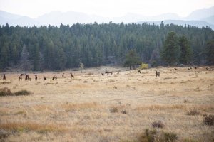

I'm happy with my 800 f/11. We took it on vacation in October and we were able to photograph things we'd never been able to before. I'd consider picking up another focal length like a 400 f/8 if it were available.
Here are two photos of an elk in Rocky Mountain National Park in October 2020. One was at 70mm the other with the 800. I'm estimating the elk was about 250 yards or 750 feet away. The 800 is exactly what I wanted it to be. A telephoto lens that allowed my wife and I to get up close to everything we wanted without the expense of high end glass. I've never owned anything longer than the 70-200 because I don't earn a living with longer glass and I couldn't justify buying anything longer then the 70-200.

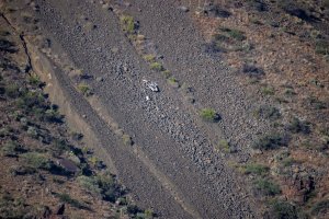

Here's another photo I took on vacation. Hand-held 1/800 iso 320. This is car wreckage on the Salt River in Arizona. The distance is 1.15 miles. The 800 f/11 enabled me to get this photo and be able to zoom in in Lightroom.

Put in context of Tony's picture and crop.
First image:- FF, 800mm, f11, iso 320.
Second image:- FF, 800mm, f11, iso 320, but cropped to 1/12 the size (a crop factor of 3.5) so ff equivalent of 2,800mm, f38.5, iso 1,120.
I believe that is more honest than just saying equivalent 2,800mm, f11. After all, if Canon said they'd make a 2,800mm f40 everyone would laugh, but Tony's picture proves it is actually usable.
Sheesh, that sounds like a rough vacation. Glad to hear you walked away from that.
