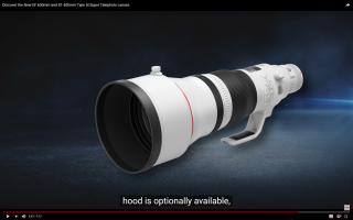

Starting from 3:00. There is even an additional switch to control the sensitivity or as they say “speed” of manual focus.
Thanks. I did wonder when I saw those switches. I've only used focus by wire on the 85L II and I've no doubt the implementation will be better here, but I dislike it, and it would put me off upgrading even if I could afford to.
Thanks! And ugh. I saw the line in the feature list, “Improved, flexible focus control with a customizable electronic-focus ring,” but was hoping that referred to the focus preset ring which also drives Power Focus on the MkII lenses.
The hard case is now optional– they’re including a soft case which is likely more useful for most people (I bought a LowePro Lens Trekker 600 II AW for my 600 II), but more importantly for Canon saves them money (more profit) and allows them to sell a high markup accessory (even more profit). Should one ever need to ship the lens to Canon for service (or for a firmware upgrade as was needed for the earliest versions of the MkII lenses), the hard case would be the way to go. Also an ‘optional accessory’ is the smaller for lens foot for use with a monopod. It was included with my 600 II. More profit for Canon, but IMO a pretty crappy way to cheap out on a $13K lens.
Agreed. I had no plans to upgrade anyway, but this makes that even less likely. I manually focus my 600 II quite frequently, and I’m not a fan of FBW (having owned the 85/1.2L II and many EF-M lenses which are al FBW).
