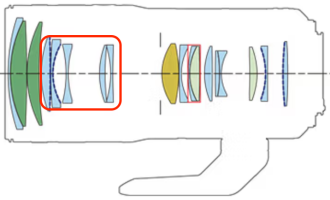

The issue would be that a telephoto zoom (e.g., 70-200mm), the lens groups that would need to move with zooming are going to be much larger and heavier than those in the RF 20-50/4. Here are the zooming groups in the RF 70-200/2.8L Z, for example:
That zooming group is larger than the two focusing groups in that lens, and each focusing group has its own Nano USM. In other words, it might not be possible with Nano USM (though they could use Ring USM). The other issue is the travel distance. The zooming groups would need to move much further in a telephoto zoom, and that may present a problem for a repurposed AF motor, I'm not sure.
The other issue is a marketing one – the RF 70-200/2.8L Z lens already exists and with the PZ-E2 accessory mounted it is a Power Zoom lens meaning Canon already sells what you're asking for. But it's not a cheap setup...
OTOH, they could conceivably make an 70-200mm f/4L PZ lens to match the new 20-50/4L. Time will tell.

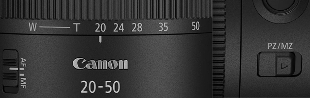

Bryan/TDP provides a more complete description of the zoom functionality, which turns out to be both of the options that were debated (rocker switch vs. free rotation). That is consistent with what's suggested by the zoom markings on the lens.
When the zoom ring is rotated within the focal length numbers range, the zoom ring provides conventional manual control, though it [is] still electronically powered. Pulling back on the spring-loaded PZ/MZ zoom mode selector switch opens the gate, enabling zoom ring rotation into the W—T range, where the zoom ring electronically imparts adjustments at the rate selected by rotation angle.

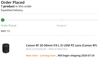

Yes I have pre-ordered a few 😅

The W-T zone works like an analog control, so you can adjust the speed of zoom by rotating more or less, and it is spring loaded.

Having big and heavy zoom elements is a real problem they will have to solve. It will probably have to be variable aperture with software correction to keep exposure constant while zooming. I don't see how they will bring the small and light weight power zoom series to longer apertures without it.
About the, RF 70-200/2.8L Z and PZ-E2 is a great lens but the price and size does not really make sense to pair with a RF 20-50/4 PZ. I will never own it due to cost, might rent it if I need to.
