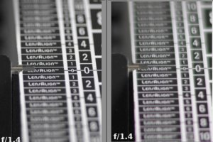

Here I've allowed myself to switch the 35mm II for the 55 Otus (a lens with similar blur characteristics as the 35mm II) as the way the focusing scale is shot makes it more comparable to another standard lens, specifically designed to under-correct some aberrations :
As you can see the "LensAlign" word blurs in the exact same way whether it's in front or behind the focal plane with the Otus (or the 35mm II). On the contrary on the lens with poor spherical aberration correction, it blurs in a strong double edged fashion in front, but in a very smooth, readable way behind.
And here's the big deal : with the Otus (and the 35mm II), as soon as you're past a certain number, you can no longer read the word, and there's practically no difference in the look of the "LensAlign" word : it's as if the LensAlign word is repeated in the exact same fashion afterwards, with lots of well defined edges which start to intertwine with each others to the point that the word becomes undistinguishable and that everything becomes flat.

On the other hand, on the lens with strong spherical aberration, the "LensAlign" word remains readable far into the blurred area behind, and there's a strong difference in how that word looks between the numbers 5 and 10, for example. I think that this is a more elegant way to fade into the blur, but, much more importantly : it preserves distance information better since you can still see what the object is !
The same thing may apply at longer focusing distances, or even when closed down (depending on lens design).
The EF 50mm f1.2 behaves to some degree like the under-corrected lens, at least around f2-F4 in the centre. It's got a lot of other aberrations that make its overall bokeh performance questionable, particularly wide open and off-centre, though.
