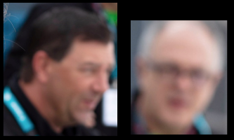

A practical illustration of the problem :
https://www.imaging-resource.com/PRODS/canon-5ds-r/Y1C6A7739-35LMarkII.HTM
In that shot the two blurred men are at a distance from each others. What I'd like to see from my ideal lens is the traduction of that fact into how the blur behaves. Yet what do we see ? The blurred edges of the objects are similar regardless of the distance (see for example how the neck strap of the guy behind is just as sharply defined as the one from the guy in front). Maybe my brain is stupid, but to me this is difficult to process : I know that these guys are at a distance from each others (the size of their respective heads should be enough to know it, unless something quite bad was unraveling to their physical integrity), and yet they look like they're painted on a 2D canvas.

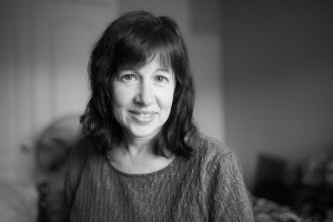

"3D effect" is just fine on my EF 35mm f/1.4L II. I'm very impressed with it for a wide angle lens. Sharp as heck too.
Forgive me for picking nits, but I do not think the picture supports your opinion in regards to the blurring effects visible between the two people. In the near neck strap, I can see there are white words or graphics repeated in a pattern which are completely lost in the far strap. Additionally, the far strap is blurred to the point of being semi-transparent as is clearly visible with the red shirt logo and more subtly visible as part of the strap almost disappears into the black shirt.
In regards to their faces, the near face includes just enough detail to see some skin folds around the mouth, eyes and interior shaping of the pinna (ear). Note that I shrunk the near face to better match the size of the far face.
Certainly I am zooming into small details here, but these were things that were evident to me from your thumbnail image. OTOH, we are discussing opinions around subjective impressions, so all I can really say is that my opinion on this matter does not match yours.
I own the 35LII, and I do like it. I have many pictures taken with this lens that I think are wonderful. At the same time, for some reason, I often prefer the look I get from the 35L, which I also own. Technically speaking, the 35LII is much better than the 35L. Sharper, less aberrations, smoother bokeh, better AF, weather sealing etc. But the most true to life images I get, are taken with the 35L.
I don’t think the 35LII produces flat looking images, but the 35L is better in that regard.
