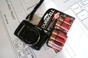

Dear Great Teachers and my friends.
I have very old Canon point and shoot SX 160 IS, and want my wife to use, when she have vacation in Thailand next week. Yes, after 5 or 7 years, the Big button CR 2025 battery for time teller in camera not work, Yes, I change the new battery.
The question for you, Sir/ Madame = I try to use the Cheap 2 AA Panasonic Batteries ( from Dollars tree store = 4 AA Batteries for 1 US Dollars)-- I can shoot only 4-5 photos before power in Batteries run out, But I check with my
meter= the batteries still in full power. BUt, If I use 2 Rechargable Batteries AA " ENELOOP", Yes, I can shoot more than 80 + photos.
The question for you = WHY ?
Thank you, Sir/ Madame.
Surapon
Dear friend Surapon.
I imagine that you refer to cheap batteries non-rechargeable AA. These batteries have a nominal voltage of 1.5 volts but during a shot with flash on, suffering a large voltage drop to about 0.9 volts. After a few minutes, the voltage recovers, but the camera has already fired the low battery alert, and will only return to normal operation when removing and installing the batteries again.
Some models of point and shoot camera has a setting in the menu where you select which type of battery is inside the camera. Thus the camera will not trigger the low battery warning, that occurs when these transient voltage drops, typical of alkaline batteries.

I suspect you are right-on. The cheap batteries have a high internal resistance, so the voltage drops when a load is put on them. The Eneloop batteries are pretty good as far as internal resistance. My new toy battery checker measures internal resistance, and some of the other high end batteries of the same age have much higher internal resistance. I can only imagine that the low cost batteries that were not intended for high power use will run down quickly.
If you want throw away batteries, get some Duracell batteries. They hold up well.

Thousand Thanks, Sir, Dear great Teacher Mr. ajfotofilmagem.
I have learned some thing new in every days.
Surapon.
