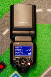

Update with details:
  • For the fourth time this week, my battery has died on me within a day(ish) of it being fully charged, and without any flash counts.
  • While I didn’t take any observation notes the first three times, I did on the last. Here’s what I observed:
  • My battery went from full charge to empty within ~30-hours, and with a 0 “full flash count”.
  • For my observations, I only turned on (then soon off) my EL-5 six times, and each time only for a moment that was long enough to check the battery’s “information” (as shown on page 47 of EL-5 manual), which I consider a nice feature to have. (y)
Here’s my results:
  1. 0-hour: 100% charge
  2. ~8-hours later: 71% :cry:
  3. ~12-hours later: 65%
  4. ~16-hours later: 45%
  5. ~24-hours later: 23% :sick:
  6. ~30-hours later: 6% then 0% within two minutes of checking.
I suppose I was lucky to get a reading on my last check because as soon as I pulled out my camera to snap a picture at the 6% mark, the charge fell to 3%, then totally off, but not before I snapped this picture showing a “0” flash count at 3%. What I don’t understand is why the “recharge performance” appears so good.
I received a new battery yesterday, so I’ll run it through a few tests to see if I just had a faulty battery with my flash, or it’s something more serious. I don’t like when my honeymoons with new gear are short, but thankfully I still have one remaining 600 EX-RT as a backup because this time I didn’t sell all my old gear at once. :)
