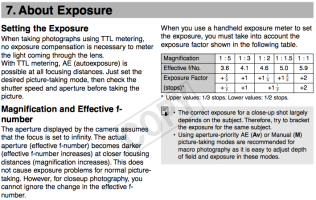

Marsu42 said:
neuroanatomist said:
I suspect what Marsu42 is referring to is the decrease apparent aperture, the light loss you get as magnification increases.
Indeed, but it's not "apparent" but for real, unlike Nikon Canon just chose to hide the fact that a f2.8 lens @1:1 doesn't get f2.8 light through anymore... that's why the shutter speed gets longer like by black magic. I just read up about it again, it's called "effective f-stop": http://www.cambridgeincolour.com/tutorials/macro-lenses.htm
What's your point? 'Effective f-stop' and 'apparent aperture' mean the same thing. The light loss is real, but the physical aperture is not changing size. You can't say f/2.8 becomes f/5.6 at 1:1, any more than you can say that an EF 100mm lens becomes a 160mm lens when you mount it on a crop body.
If you're using a Nikon camera in Av mode and go to 1:1 magnification, the shutter speed doesn't change and you get shots underexposed by 2 stops? :o I didn't know that, but if true I don't think that makes sense. An autoexposure mode should give me a metered exposure, period. Therefore, I'd expect it to compensate for the light lost at 1:1 by altering the shutter speed (and/or ISO, if that was set to Auto).
Also, I'm not sure why you state, "Canon just chose to hide the fact that a f2.8 lens @1:1 doesn't get f2.8 light through anymore." That's a pretty bold and unsupported accusation. Unless you think they're trying to hide that imformation in plain sight…such as by printing it right in the instruction manual for the lens. ::)

Neuro, I remember reading that there is a difference in the way Nikon displays the light loss vs. Canon (in one of Scott Kelby's books, I think), but at the end of the day, exposure is exposure, and the light loss (and the need for high ISOs when shooting in natural light) is the main reason I think that FF is better than crop for macro, at least for my needs.
If you're using a Nikon camera in Av mode and go to 1:1 magnification, the shutter speed doesn't change you get shots underexposed by 2 stops?
Nope, afaik they simply show the effective f-stop, and then you know why the shutter speed suddenly gets longer.
I'm not trying to pick a fight, if you need some mudslinging go talk to some well-known contributor who responds to that. But I'm as a simple Canon beginner didn't understand (and even realize) the problem at macro distances, and only wondered why I ran into such low shutter or high iso values. Yes, rtfm, but still.
Simply giving the effective f-stop rather than the nominal value makes more sense to me, and everything else is "hiding" not in a moral sense, but as a loss of potential information.
So, you'd prefer that the camera report an aperture that is not the one you selected, whereas I'd prefer that the camera show the selected aperture and adjust the exposure to compensate.
It's not a moral issue, which calling it 'hiding' implies. Rather, Canon and Nikon have simply chosen different ways to represent the loss of light at high magnification.
As a side note, that must mean a Nikon camera will display an aperture value that is smaller than the lens is physically capable of achieving. So if we're going to make it a moral issue, Canon is hiding something, and Nikon is lying about something else. ;)

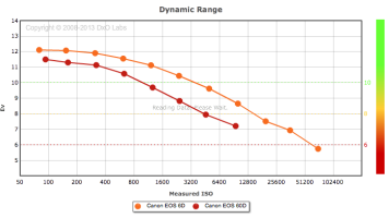

Marsu42 said:
That, the dr loss at the higher iso for ff, the working distance & swivel screen still make me use the 60d :-)
You seem to be ignoring the fact that the APS-C sensor has less DR than the FF sensor, at all ISO settings.
ISO 800 on the 6D has the same DR as ISO 100 on the 60D - a 3-stop advantage for the FF sensor. At ISO 400 and above on the 60D, the 6D has approximately the same DR at a 2-stop higher ISO setting. Where is the DR advantage of the APS-C sensor?
Swivel screen? Canon's free EOS Remote app allows remote live view from the 6D, and may be more useful than a swivel screen. Granted, the 6D is the only Canon FF camera with Wi-Fi (so far)…but there's also CamRanger for the others.
As for the working distance advantage, that's the same argument for why APS-C is better when you're focal length limited in telephoto situations. It's only an advantage if you require more than ~8 MP for your output (i.e. you're printing larger than 16x24"/A2) and you're shooting at relatively low ISO. For normal and small prints, web use, or if you have to boost the ISO, the cropped FF image will be as good or better.
Ah, you're comparing a 2012 camera to a 2010 camera. Let me counter this: The 7d has more dr at iso 800 than the 5dc, giving crop a solid 2-stop advantage over the FF sensor :-> ... the dr argument is just a side note, it just happens to add up with the fact that the ff advantage is less than usual for macro.

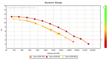

Ok, let's compare the 6D from 2012 to the newer 70D from 2013 - the latter is basically the same as the 60D from a DR standpoint. Still no DR advantage for APS-C.
