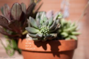

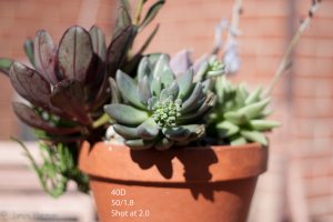

I have owned a 40D since 2008 and am waiting for the 5D3 but I have shot with the 5D classic ad 5D2. I can say that the 5Dc is better image quality than the 40D and the 5D2, well, it beats them both.
Here are two shots I took and have posted here before comparing the 40D/50_1.8 and 5D/85_1.8 - both at f2.0 with no changes at all in post production.
The bokeh is way better on the 5D, IMHO. As stated previously, if you are wondering which one to get, get the 5D2 and some nice glass :-)
