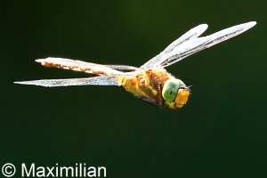

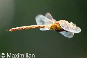

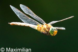

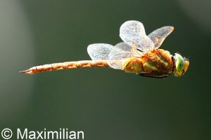

Talking about highlights and backlit ... how about backlit DIF?
Again a green-eyed hawker. Those seem to be the "easiest" to DIF for me.
This second set is not so sharp and less detail but more for our avionic experts:
Look at the hind wings and the work angle. Looks like flaps on a plane, doesn't it?

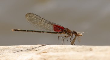

I'd love your advice.:) You, Alan and several others have taken some really awesome shots!
I did observe them for about 2 hours (while waiting for the Osprey to arrive, what I learned is that this species
hover for about 2 seconds and not in the same location! I did try to pre-focus at the approximate distance but the auto focus
(and myself) really struggled.
I did manage to capture a few in flight but not the best shooting angle.
