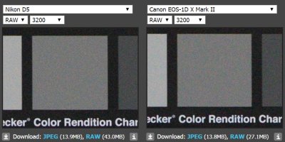

index.php
I don't know what you were looking at or comparing as you only posted the DXO graph.
I've attached a screenshot of the DPR RAW studio samples for the D5 and 1Dx-II.
What we are looking at here is the roughly 18% grey patch on the colorchecker (which corresponds with DXO's SNR-18% graph)
Lenses used in the DPR studio test:
Canon 85/1.8 vs Nikon 85/1.8
According to DXO lens test, The Canon 85/1.8 has about 0.1Ev more vignette @ f/5.6 and has in the range of 0.2-0.3Ev less transmission than the either of the Nikon 85/1.8 variants.
So the 1DX-II has roughly 0.3Ev less light at the sampling point given the relative position of the sampling point in the field of view.
Given that the Canon 1DX-II 18%patch looks extremely highly similar to the D5 18%patch even with 0.3Ev less light, is it not a fair assessment that the Canon 1Dx-II is slightly better. This happens to line up :P with the SNR18% graphs produced by DXO.
