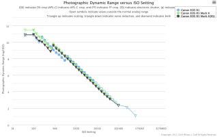

except for the r1 at ISO 400-1600, what happened there?
Bill Claff relies on user-submitted RAW files to generate his data. I strongly suspect that whoever sent him the R1 files used electronic shutter instead of manual shutter for the captures. Notice how with the other recent(ish) R bodies (R3, R5, R5II, R6, R6II) there are plots for both mechanical (unlabeled) and electronic (ES) shutter, but for the R1 there is only one entry and the PDR is lower than expected. But it's pretty much spot-on with the R5II in ES.
When his R1 data came out lacking the mechanical vs ES comparison, I offered to send him file sets but didn't hear back. I'll contact him again, (by email though we are practically neighbors...he lives in the next town over from me). Or maybe I'll just shoot the files per his specs and send them.

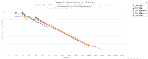

Reflecting on the above, if the R6III fits on those graphs where expected, a conclusion one might arrive at is that Canon's sensor design has evolved to deliver roughly the same IQ regardless of pixel size, meaning they could potentially go to 60 or 80 or 100MP with no loss in IQ.
