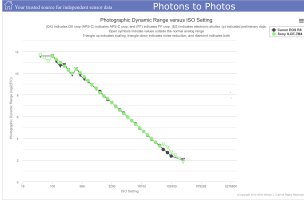

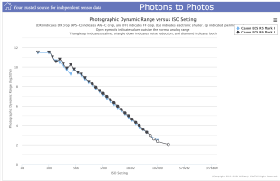

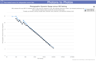

Here is actual evidence about pixel size. At high iso/low light, which was the initial topic of the disscusion, the DRs of all modern Canon sensors are the same within experimental error. Differences appear at low iso because of the different amplification modes and data transfer rates amongst other factors. For pairs of similar sensors, like the R6 and R5, and R6ii and R5ii, the DR curves are very similar despite the factor of close to two in pixel count.R5_R6.pngR5ii_R6ii.png
